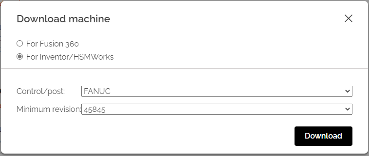

New machines format
Machines in the new format (.mch) can be directly used by Fusion only. Inventor CAM and HSMWorks cannot consume them directly. However, it is still possible to use new machines for configuring universal posts, which are designed to work with external machine configurations. For this purpose machines in new format can be downloaded as a single package (.cpsz) with any post. This packaged post can then be selected for postprocessing instead of a regular post. You cannot use a separate machine for posting with this post, as it contains embedded machine already.

Usage
To use a machine in new the format in HSMWorks or Inventor CAM you need to do the following:
